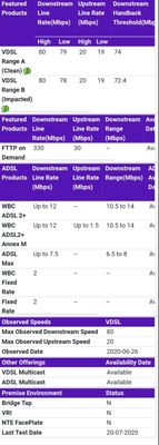

If you enter your phone number here, can you post the results ( remove your number when posting)

The first thing to establish is wether you are getting close to what is predicted for you location, no use complaining if you get ( for example ) 30Mb, on a 55Mb product if 30Mb is all your line can deliver , and if you are way off what’s predicted, what’s been done to remove any potential issues within the home.....are you using a extension socket or the master socket, have you done a quiet line test , dial 17070 from the master socket test port with a (preferably) corded phone take the quiet line test option and listened to see if there is any noise ?

So one of you wanted to see this, poor image quality as I had to reduce file size sorry
