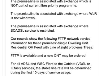

 this is what it states

Its nothing to do with Virgin media, how that is delivered is totally irrelevant.
The checker says it is an overhead feed (from a pole) but trees are a problem.

So it's an overhead feed but there's issues with trees blocking line of sight from the pole to your home.
It could just be tree branches in the way.
You cannot get it the same way as Virgin Media, both networks are independent of one another.
Also Openreach has overhead infrastructure in your area to deliver FTTP so underground isn't possible.
