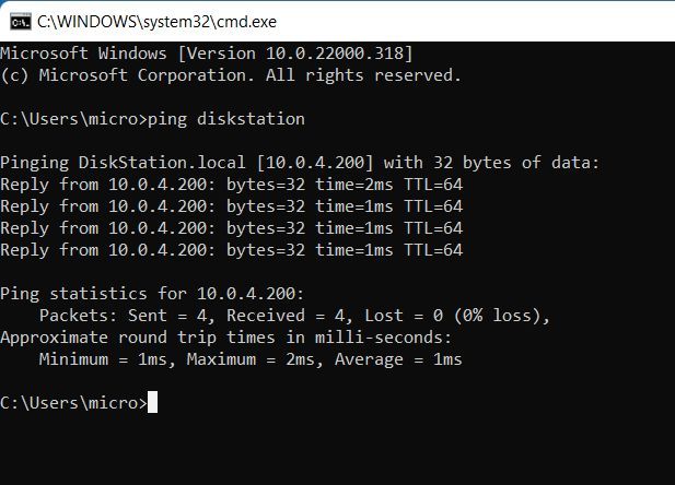

I've just tried pinging "diskstation" on my network (which uses an RT-AX88U router) and it works fine, although I have to wait another week before my BT FTTP is installed, so I am having to access the internet via the BT mini hub that they sent me to keep me going (my Plusnet service was terminated prematurely) and keep swapping between the two networks, depending on what I want to do.

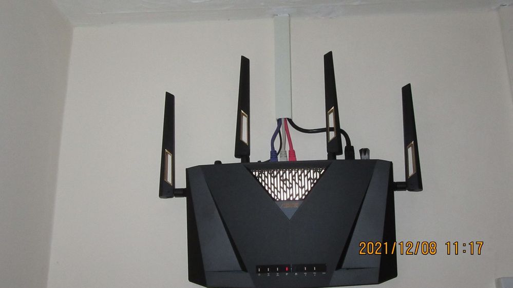

IMHO ASUS routers are a good third-party alternative. I currently have the RT-AX88U, which is good if you want a wall-mounted unit that you can feed from above as in my case (see photo) but a similar spec but slightly newer model is the RT-AX86U, which is great if you want to have it on your desk or a small shelf as it has a small footprint, but on the downside, it cannot be directly mounted onto a wall. There is a very active forum of experts for ASUS routers as well and an alternative modified version of the stock firmware (called Merlin) if you want additional features.
