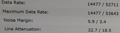

That's after i reset it it looks normal to me apart from being 20mbs slower than when i signed up but thats a different BT issue.
