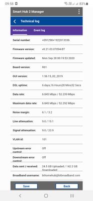

I can have posted up the router stats, but right now they don't show anything obvious as the issue is not present. Even when we do have an issue the stats are not affected (no loss of service and no jumps in attenuation etc)

looks like a good solid connection with actual at attainable speed with G.INP active giving lower noise margin at 3.2db and higher connection speed
