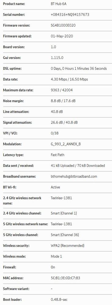

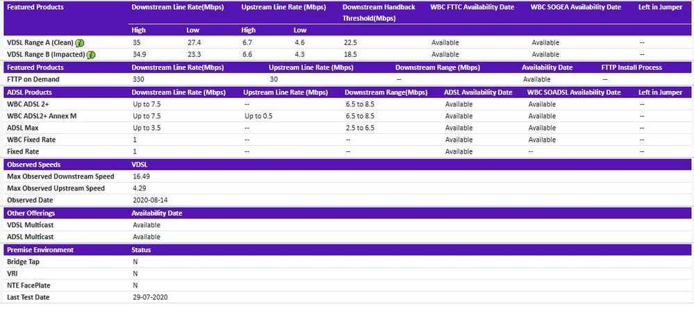

from your description you do have a noisy line - the line should be silent when using a corded phone and maybe a High Resistance fault on your line which is causing the drops when you receive or make a call.  constant drops in conenction will see the DLM take action by reducing you speed to try and stabilise your line
from your stats you have an attainable of 42mb but are nowhere near that

Thanks.  I'll try reporting it as a noisy line.  By the way ... what should I be looking at in the stats?  I'd like to understand them better.
13,334 Views
Message 6 of 17
Re: Is new BT Smart Hub Causing My Drop Outs?
Go to solution
Mainly data rate and max data rate about equal and noise margin 6.0/3.0
