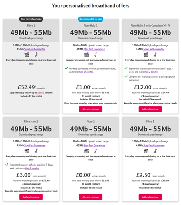

At the end of last year this changed and my download speeds dropped to around 65 Mbit/s. At the start of this year the speeds dropped again to a fairly consistent 55 Mbit/s. I assumed the Fibre 2 speeds had been removed from my Fibre 1 package. However, when I login in to BT to upgrade my package the only options available are packages with a maximum download speed of 55 Mbit/s.

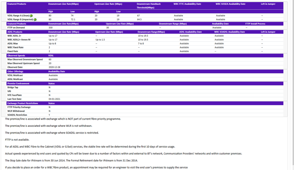

The output from the Broadband availability checker appears to show my maximum observed downstream at the end of last year was 60 Mbit/s.  The downstream handback threshold is higher than this, as is the line rate.
The maximum observed downstream value in November last year was around 75 MBit/s. My observed downstream rates are now 55 Mbit/s in January.
