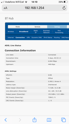

Our other faster line Is now experiencing FEC errors of around 2,000-4,000 per two seconds.
Can this be looked into as well? As pages are very slow at loading

Have you check the second line for line noise by doing quite line test?

There’s no crackling or hissing, just a very faint fuzz.
here’s the stats a few hours later

any noise on quiet line test is a problem and if you have 'faint fuzz' then before reporting line problem I would redo the quiet line test but using a filter in the  test socket. If still there then report a phone fault to 151  if it disappears then problem either with master faceplate or internal wiring
