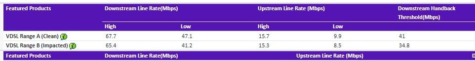

Morning Folks
Just renewed contract with BT and thought I'd check my line stats as I hadn't done it for a while.  It looks like DLM has applied a banded cap to my d/s speed - I presume in response to a fault that's occurred at some point.  Got a new laptop set-up a few months ago and didn't get round to monitoring line stats unfortunately so no idea when fault(s) occurred or how long ago.  From what I can see the last re-sync occurred around 10 days ago with only 2 errored seconds so line looks good now at least.
Telnet stats show I should be able to sync at approx. 61Mbps (line stats reported at 60808Kbps) but my current downstream rate is only 44Mbps (line stats reported at 43998Kbps).
So how do I go about getting the banding removed and/or get a DLM reset done?  Thanks.

in order for the forum members to help please can you post the stats from your router (if hub enter 192.168.1.254 in your browser) and if  HH5 then go to troubleshooting then helpdesk and if HH6/SH2 then advanced settings then technical log information .
enter your phone number and post results  remember to delete number   https://www.broadbandchecker.btwholesale.com/#/ADSL
it can take a few weeks for the DLM to see you line as stable and start to release any banding

Thanks for the reply.  I have an Openreach HG612 set-up not a HH.  Already ran the checker with results below:
