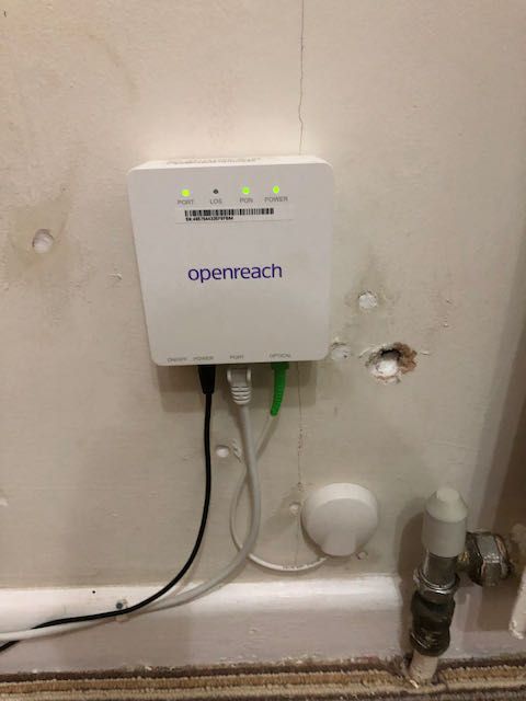

As regards feeding the optical cable through as you suggest (if the master socket is removed) there is an official bit of kit that should be used for this purpose.

Go to solution
It is the white cap on the wall from which the fibre optic cable emerges.

Go to solution
Its not a connection box, it is just a plastic cover. Best option might be to fit faceplate to pattress with a hole large enough for the optical connector to pass through and then fit the white round cover over the faceplate. The bend radius of the optical cable cannot be too severe as it will kink the fibre.
