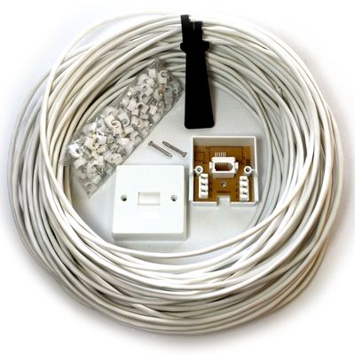

Thank you, I assume that something like this will do and that my electrician will be able to do this.
Do BT offer their own extension kit
