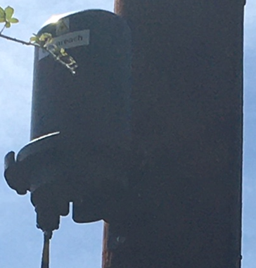

Sorry one more question/suggestion.
I think what is occurring is , Cabinet 2 (my cabinet) is copper all the way from the cabinet for all customers (hence the slow speeds).  Whereas Cabinet 4 the wiring from the Cabinet has been renewed so it is Fibre to mid way boxes (I am sorry I don't know the correct terminology) and then copper from there to premises.
Attached is an image of the mid way box outside my house that is part of Cabinet 4's feed.

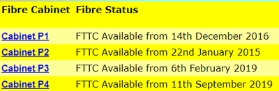

Message 17 of 21
Re: Missed off the OpenReach Fibre Survey - Neighbours have it but BT deny its existence outside me
To add further evidence to this theory as per the below data Cabinet 2 was FFTC enabled in Jan 2015 where as Cabinet 4 was only FFTC in Sept 2019 thus I think the cabling from that Cabinet is way better as it was only installed recently.

@Starwire  will be able to tell you exactly what that is. He'll possibly drop in later.
Is there anything like this on the poles near the houses you think have FTTP?
It matters not when a cabinet is upgraded to FTTC the existing copper from the cab to home is still used. The only new cables are the fibre to the DSLAM and the copper link cables between the PSP and DSLAM.
That’s a Fibre Node, possibly a Splitter but I couldn’t tell without looking inside it.
As no FTTP is available I’d imagine the Fibre is for the DSLAMS. Its unusual for the Fibre to comes from Overhead but it’s not uncommon.
