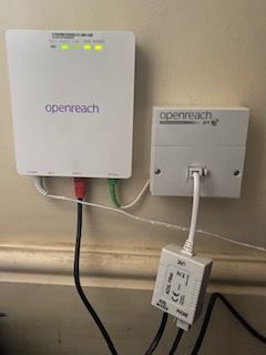

@meg_
As you now have a faster connection, maybe you could upload a pic of which device (on the wall) the faster connection is coming from?  And if possible the Router?

@CJT80
This message comes up when I try to upload the photo 😞  Unsure how to make the file smaller?

Re: Mitel Office IP Phone DHCP Discovery Issue
 Yay! Fast broadband is connected to the one on the left with green lights, slow broadband is connected to right socket
