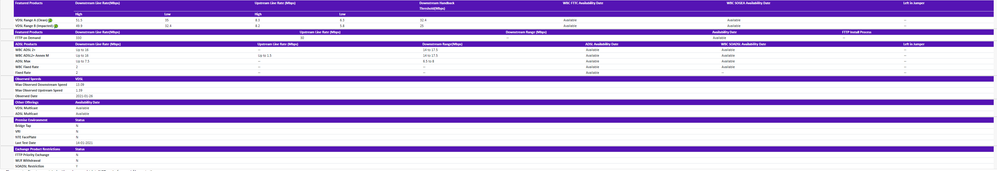

So i am on the fibre 2 package and a couple of days ago my speed dropped completely, usually i get around 33MBPS Download and 3MBPS Upload but i am now lucky is i get 1 up and 10 down. I'd done the obvious things, check cables, reset the hub and even used BT's own trouble shooter but according to that 12MBPS download is not an issue.  I have had faults with BT in the past but they were to do with my cabinet. the last one a non openreach engineer somehow connected my line to someone elses. I have taken a look on the forum about a fix for this new issue and i've noticed most people post stats from their hub manager and get a answer as to why the speed is dropped. sorry to be a pain but i'm going to do jus that. i did try calling BT but was on hold for a very long time. Information from my hub is below!!  Thank you in advance!!
Product name:
BT Hub 6A
Firmware version:
SG4B1000E020
Firmware updated:
20-Dec-2020
Board version:
1.0
Gui version:
1.115.0
DSL uptime:
1 Days, 22 Hours 57 Minutes 53 Seconds
Data rate:
1.27 Mbps / 12.98 Mbps
Maximum data rate:
921 / 17344
Noise margin:
6.2 dB / 7.1 dB
Line attenuation:
42.4 dB
Signal attenuation:
30.1 dB / 42.4 dB
VPI / VCI:
0/38
Modulation:
G_993_2_ANNEX_B
Latency type:
Fast Path
