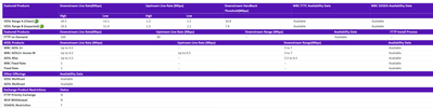

can you enter your phone number and post results  remember delete number  https://www.broadbandchecker.btwholesale.com/#/ADSL

Thanks for responding.  Me details are below.  I just put my neighbours address in and they are on cabinet 32.  I can understand if we are in separate detached houses however we are in the same terrace. Looks like a wifi provider is my only route if openreach will not move me.  I can't understand why my house was connected to a completely different cabinet though when all the other house in the same terrace are on cabinet 32.
 Exchange MALDON is served by Cabinet 21
