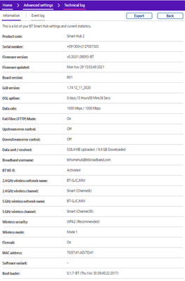

Thank you for posting and welcome to the Community. The IPC6023 error usually indicates a problem with the speed of the Broadband connection. If your broadband has had multiple disconnections in a short space of time, the speed could have been reduced to try and help improve stablity.
To get a better understanding of how your Broadband is performing, please could you post your router stats?
If you are using the BT Smart hub you can get your connection stats by, Opening a new web browser on your connected device and type 192.168.1.254 or bthomehub.home into the address bar. This will open the Hub Manager.  Click Advanced Settings’ and then ‘Technical log’.

Hi @PaddyB ,
Thanks for the reply. I have checked the network speed,  consistently over 60Mbps down and 20Mbps up.
The router can stream Netflix, Amazon Prime & Now TV plus entertain a gaming son on a variety of devices and connections until we try and use our BT TV box.
Snip of Technical information attached.
Cheers,
DS
