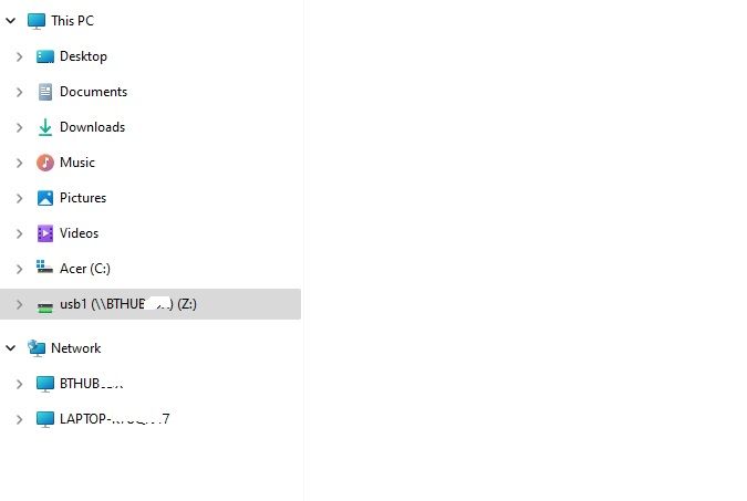

On a separate note though, I now wonder what the use of the USB port is on the back of the smarthub.  I have attached my brand spanking new 1 TB HDD and the hub sees it and knows it is there - should I be able to see it fro my PC though?  Just wondering what the designed use of such a port is?!

Yes, you can map it to a drive letter, I have a 2Tb drive connected to mine. It is very slow as it is only USB2.
Map the drive letter to \\192.168.1.254\usb1 or \\(hub name)\usb1

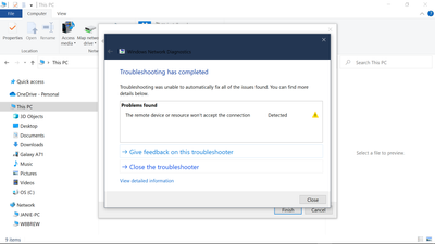

Sadly I get no connection, just:

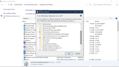

and the reference to SMB I have seen elsewhere - I have checked my W10 features and SMB is "on"...

Just noticed your Hub isn't visible under Networks either.
Is your Network set to Public or Private?

I can see my hub - can I ask how I would know?

Update, it was set to public, looking at the options I suspect private is what it should be?

Its in Settings > Network and Internet > Properties in W11 but I can't remember if it is the same in W10, but it will be somewhere in Network settings.
Set it to Private
