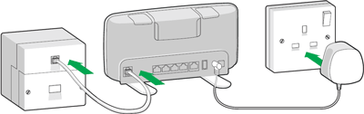

If your socket looks like one of these:
new_setup_3
Then you don't need another standalone filter.
Just plug the router cable you normally plug into the separate filter into the smaller of the two holes, and your phone cable into the bigger hole.
new_setup_2b
You can leave the filter that came with the router in the box it came in.
