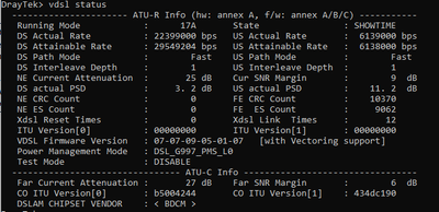

Stats from my router just now show the attainable rates are much higher than that being set:

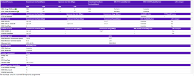

And the exchange/cabinet info is:

Just spent the last 2 hours in discussion with tech and account support and found out a few things... my line sync speed is capped at 25Mbps... end of! Nothing BT can do to give me back the speed I had.
What happened was in September I was presented with an offer to switch to BT Fibre Essential at a discounted price (not Fibre 1 as I originally said, but read on). When I tried to set it up online it wasn't recognised, so I called and placed the order where I was told it would be set up with the offer price. The range was up to 35Mbps
When my bill came through in November it was at a higher price so I called to (re)explain the deal I had been offered in September and I was told it would be corrected. I then received an email with the new billing details and I failed to spot that it had been set up as Fibre 1 with a lower speed range of up to 25Mbps. I did however spot my speed drop the day after I received the email and called again about the lower speed, asking if it was capped as a result of the bill correction. I was told it wasn't and that set me off on my first foray with the tech team who sent a (Qube) engineer.
When I contacted the tech team earlier today I was eventually told that my package was limited to 25Mbps and they put me through to order team who just told me they couldn't offer me a higher speed. So they put me back to the tech team who checked the line and are also saying the higher speed is not available - despite me having the higher speed until I queried my bill.
How is this possible? Fibre 1 at a lower speed than Fibre Essential? And another two hours wasted wondering what I have to do. I can see on the BT broadband checker that 38.1Mbps is (theoretically) possible and the Draytek (and BT Hub) saying a higher sync speed is attainable.

Looking at the stats you posted the max attainable connection speed  is 29.5mb and this figure is not affected by the FTTC package you choose.  So looks the best you can get even though DSLCHECKER shows max speed range is 38mb

Thanks, interestingly I do see max attainable speed vary throughout the day, so you are probably right. I think I was averaging low 30s before the 'package change', but it has been higher.
