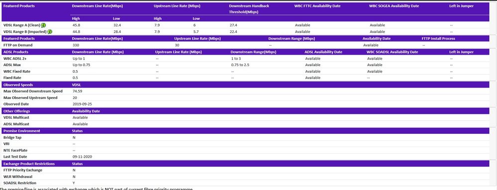

It does not matter which FTTC provider you use, the cable will still be the same, and your speed will be the same.
Enter your number into this form, and display the results here, after editing out your phone number.
Upgrading to a higher speed will not help, if your line is not capable of that speed.

hello keith, i didnt think provider would make much difference, just didnt quite understand how EE would be able to offer something no one else can offer, even their fibre standard was offering 33-36 estimate with min speed of 30.
wholesale.jpgif i am unstanding this correct i should be able recieve better speeds than what i am? please correct me if i am wrong.
Thanks

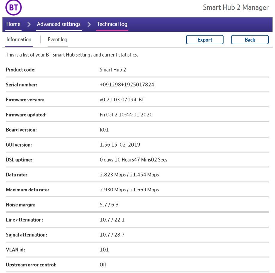

bthub.jpghere are the stats from my Hub, i cant make much sense of this apart from speed.
Thanks

Re: Old aluminium network FTTC problems
from your hub stats you are getting as much as you line can handle with connection speed virtually at attainable speed.  with aluminium lines there is not much you can do regardless of ISP
