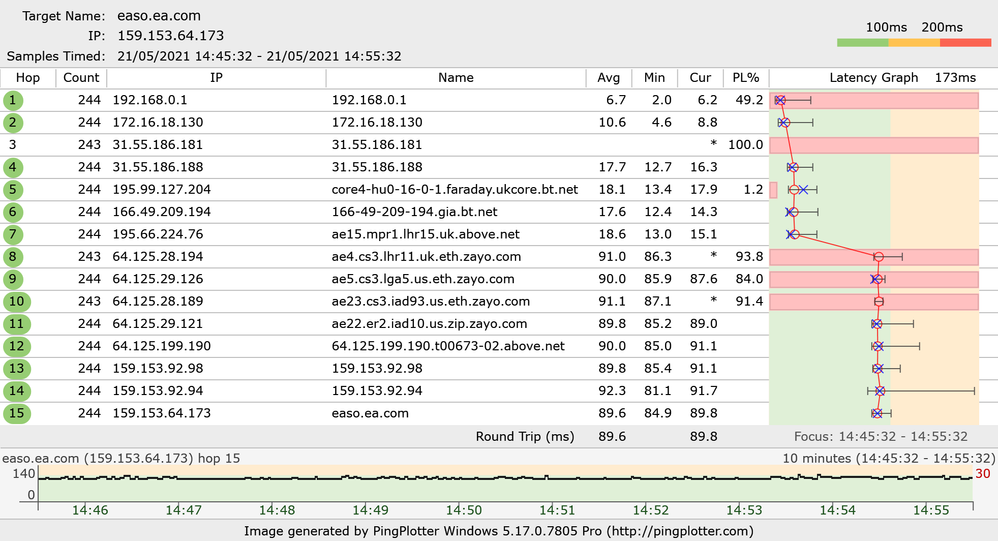

Hi, I mainly use my broadband for online gaming with friends but playing any competitve online game is near impossible with the performance im getting from my connection. The problem im having is mainly a latency issue where i'm playing at a delay to everyone else (I get a step on the enemy and shoot him first but i get insantly killed). Other issues im having are: bad quality games where every game is so one sided, skipping/freezing lag/input lag in games like Fifa, Nba, getting diconnected from other players im playing with. For example, in Nba theres a 5v5 game mode and all of a sudden 6 of the players in the game will disconnect at the same time leaving the game now a 2v2. Frequently getting timed out to game servers in Gta or when i do manage to load in to a game theres generally a low player count in the session. What i don't understand is, in games like call of duty and battlefield i have in the in game network stats up and everything looks the fine. Latency is low, no packet loss on packets to the game server and back, speedtests look fine very low ping, speeds are good and stable although sometimes i do see the odd ping spike and jitter. Pingplotter tests show there's packet loss at hop 1(my router), packet loss showing at hop 5 which is ukcore.bt(bts network), high packet loss at hop 8 to hop 10 which is zayo.com( the routing company bt uses to send your data to the game servers). This is where i also see asterisks which means my connection is timing out alot and this could explain why players are disconnecting frequently and im getting timed out when trying to load into a game server?  Is anyone else having similar
 issues? and is there a way to get this to someone from bt? Trying to explain this on the phone or through live chat always ends up getting nowhereeaso.ea.com ping plotter.png

Your round trip is very high but don’t worry if the occasional one shows 100% it’s just not responding to the test.
your issue is most likely your power lines and as gaming is one of those services were latency has a huge impact I’m afraid you may have to try a different way to connect.
Whats your own router?
Is this a gaming router by any chance from Asus or Netgear?
Where is this router located?
Are you able to test connected to the homehub to verify your latency is the plugs you use?
Do other devices that use WiFi for example suffer the same issues in your room or is your room a dead spot?
A direct cable from router to your machine is best but as you can’t do that you may have to consider extenders or a better router than the homehub. You might be able to place an extender that can be in AP mode or you may have to think about one with a backhaul channel.
AP mode is best here but requires some cable but you would only have the facing WiFi where an extender would have facing WiFi plus it’s backhaul WiFi so that increases latency.
the good news is some extenders offer fairly good latency using a backhaul, not perfect though, WiFi has its drawbacks.

It’s not unusual to see hops fail as they might not respond. BT has a good peering so it’s not likely their routing.
Unfortunately it’s most likely your home network and game servers.
Best bet is to use PingPlotter and monitor your connection as it will help to show what’s going on.
if that shows no issues it boils down to servers.
You need to run a temp cable from your pc to router to bypass the power adapters so you can test if the adaptors are an issue too.
