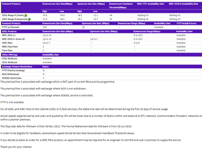

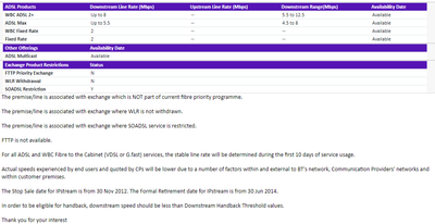

Thank you for taking the trouble to reply. The site doesn't recognise our landline number so I used the address lookup:
For our flat:
For the flat immediately above ours:

a new line will just get connected to your existing cabinet probably using 2 spare wires in existing dropwire.  anyway the other cabinet is full with waiting list so no connections currently available;le
