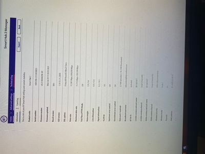

Hiya,
For the mods to help, Can you post your line stats by going to 192.168.1.254 and then clicking on advanced options, technical log. Paste what you see and someone should help you.
Did you change absolutely everything from filters and cables to the hub? Something not quite right.

Appreciate the message and yes mate.. the engineer if stuck me a new socket on! Ill do what you suggested now!

Re: Orange light every 10 mins!!!
When I zoom in it is blurred and not readable     can you use the camera function to upload the stats

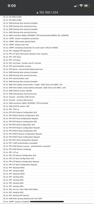

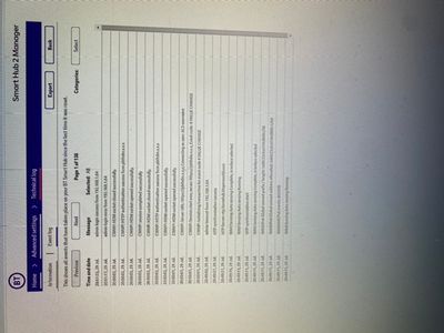

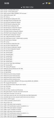

My bad!
This is the latest log for past hour roughly..
hope that helps. . noticed there’s a few bits on there that says DOWN at end of it.. dunno if that is good or bad haha!

Infact there’s a few failed/downs on there that I reckon may give you legends some idea of the issue!
4,731 Views
Message 8 of 28
You have an intermittent line fault that the engineer failed to diagnose, you need another engineer visit.
I haven't worked it out, but from your first post it has all the hallmarks of an intermittent disconnection and the log shows confirms the disconnections. Have you tried a quiet line test 17070?
