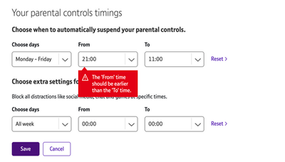

I am unable to set up parental control timing. I tried to set up parental control suspension between 21:00 - 11:00 (9pm night through 11am morning) every day.
I am getting following error message.  either i am missing something or this tool not fit for purpose.

Please find below screen shot and let me know how can i achieve this timing.

The cross day boundary time setting as a feature isn't currently supported. I'm taking this to our design and engineering team to take a look at, as we agree that this isn't a good experience.
