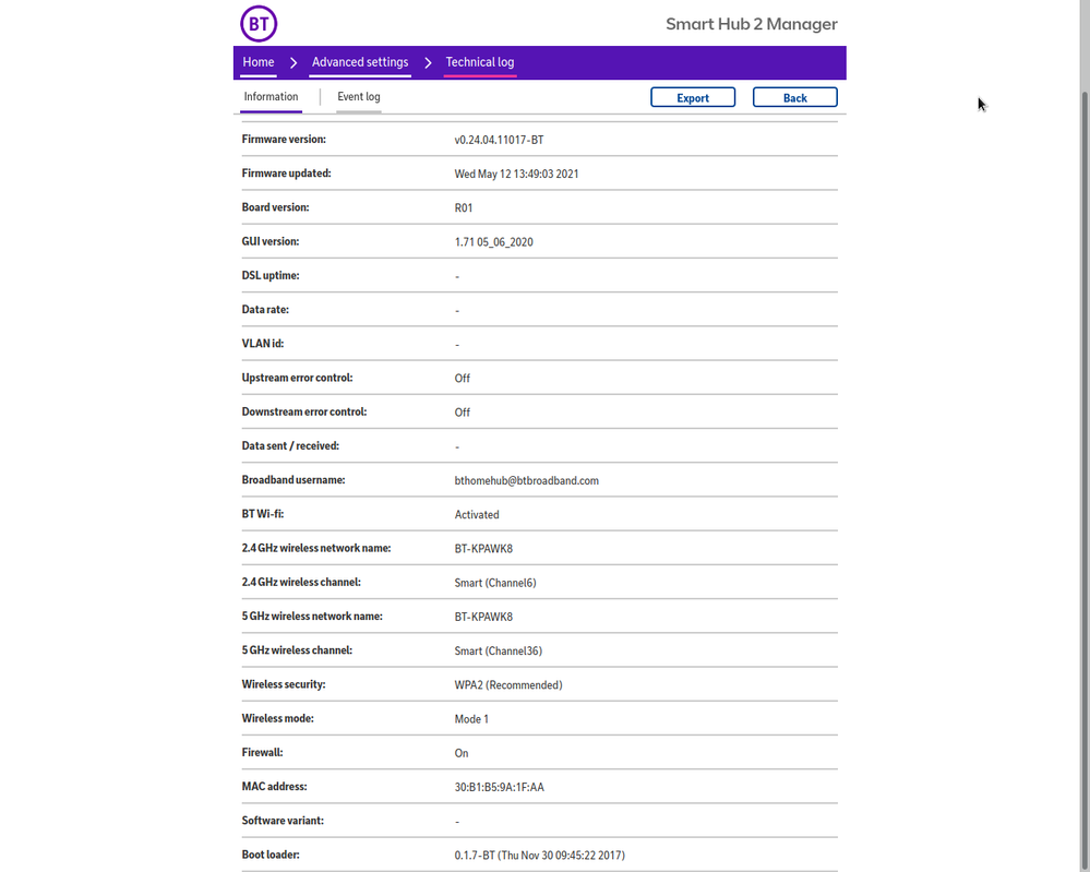

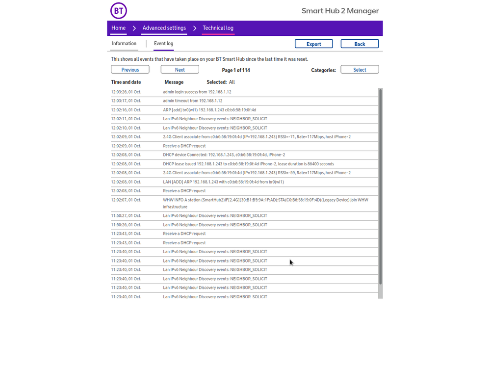

Can you post hub stats from hub manager then advanced settings then technical log information.

Hub stats
Screenshot at 2021-05-14 10-50-35.pngScreenshot at 2021-05-14 10-48-24.pngScreenshot at 2021-05-14 10-45-53.png

the hub stats don't show any internet connection or dsl connection time
there should also be max data rate, noise margin,attenuation etc

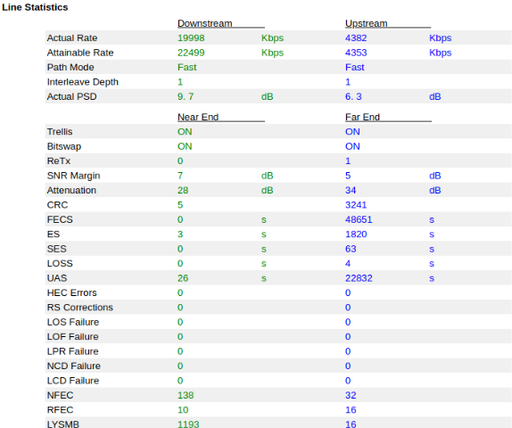

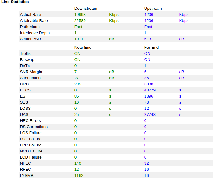

These are the statistics from Sky line showing fault accumulations before and after installation of my BT second line
Screenshot at 2021-05-14 11-13-47.pngScreenshot at 2021-05-14 11-13-28.pngof line faults
