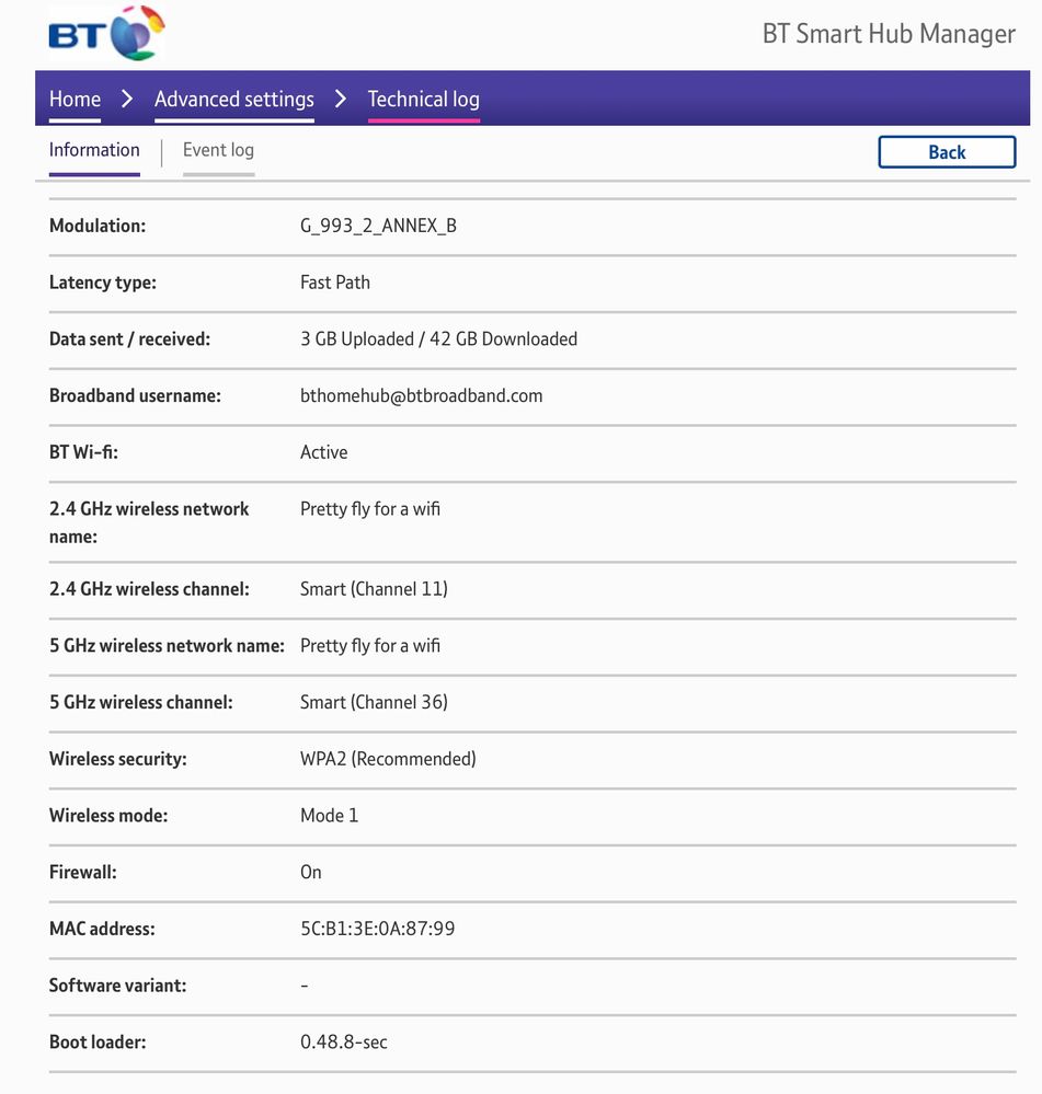

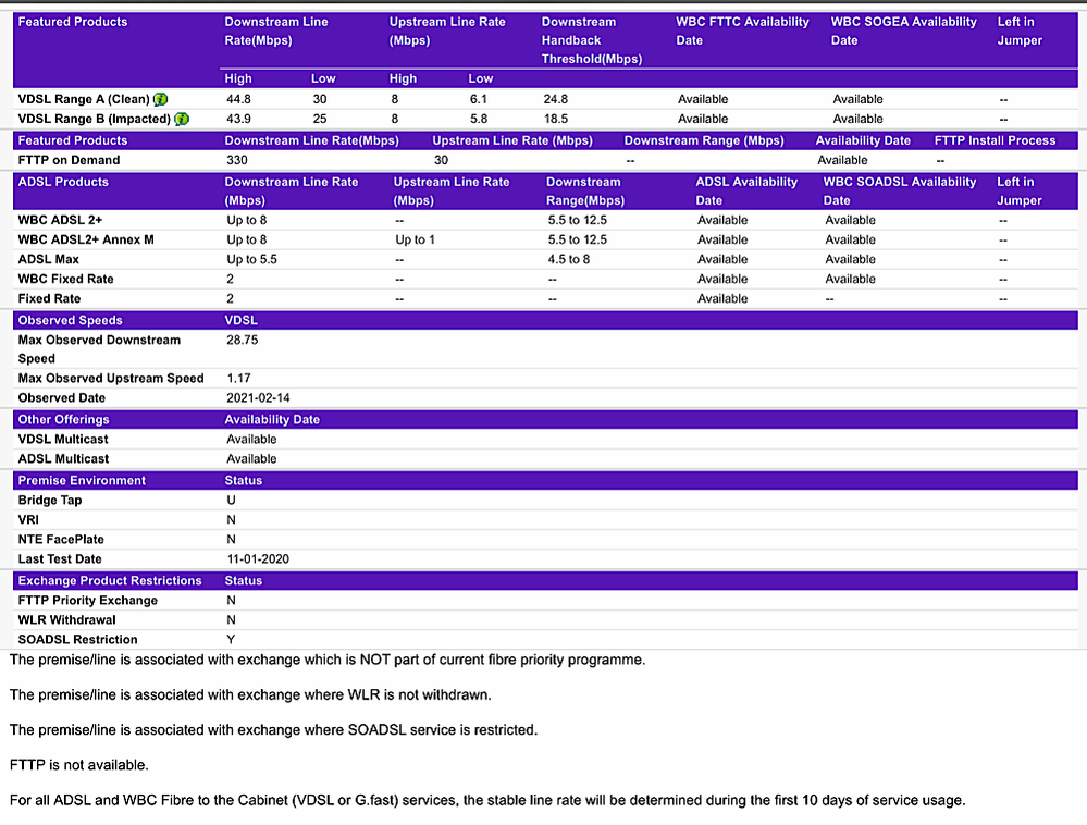

C67F50BB-532B-4AC9-BF53-AFB3BD05130B.pngE4A3F71E-A18C-4459-A073-FB3359F5BFA7.jpegE995B69F-52C2-4BAD-A7E7-6313080DEFC6.jpegI have tried the quiet line test with a corded phone and this is fine. I’ll go now and run a speed test and post the results shortly

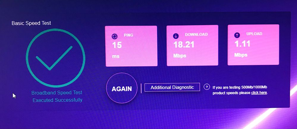

according to dslchecker results your up speed should be between  8 and 6mb not the poor 1.1mb shown in the hub.  have you tried a factory reset by pressing the recessed button on back and holding 20/30 secs until lights flash.  if you try this remember to turn off smart setup in hub manager
if that does not improve you up speed then you need to phone 150 and get broadband engineer visit
