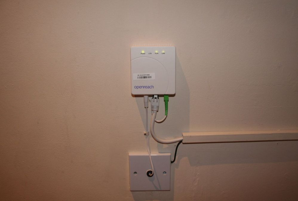

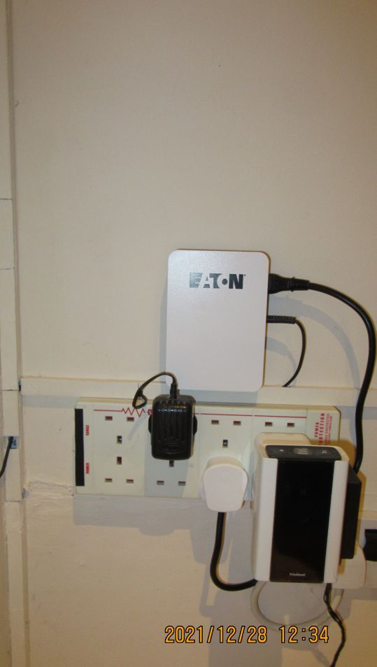

I've got the UPS, which arrived this morning, installed now. Initially, I wasn't too happy with how it looked after I had replaced the BT power unit with the UPS (see relevant photo of the ONT). Also, the plug on the UPS was a little bit wobbly when plugged into the bottom of the ONT and being black, looked ugly as well, so after considering my options for an hour or so, I came up with a plan to cut the low-voltage wire from the BT ONT plug and connect it to the low-voltage lead from the UPS. Rather amazingly, I had everything I needed from leftovers of previous DIY projects, including a correct-size cable clip and rubber grommet for the cover plate and I even managed to make fresh use of the original back box for the BT master socket to hide the connections between the two low-voltage cables. The second photo of the ONT shows the much-improved situation.
The initial situationThe initial situationThe final situationThe final situationThe UPS connected and workingThe UPS connected and working
