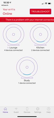

Thanks @foz and @hatton33. I’ve tried using a different Ethernet cable to connect my main disc to my router as well as swapping my main disc with another disc. Sadly, still seem to have the same issue as before.
I normally use the App in the first instance to check status, etc. Each disc continues displaying a blue light, which is also reflected on the App. However, I get a “There is a problem with your internet connection” error message (white text on red background, which is consistent with the “Troubleshoot” button that also appears towards the top of the screen).
I’ll attach a screenshot in my next post to illustrate this, which coincides with not being able to access anything on the internet while connected via PWHW.

Please find screenshot attached.

@Dan-E , this is a puzzling one. Have you tried connecting it to a different port in your router? Also, have you tried giving the discs a static IP to rule out some strange DHCP leasing issue? Any power saving settings enabled on your router that you could disable? What about port settings on the router - are they set to half duplex or full? What about the SSID’s you’re using - I assume you’ve given both networks different names? Are the devices connected completely wirelessly or are any wired? Does the connection issues you’re having occur just on your phone or does it happen to every device? Does it also still happen if you move to another room and therefore are connected to a different disc?
Sorry, lots of questions and I may not have the answers since you’ve got a different ISP and I don’t have these same issues but just trying to get me head around what’s causing the problem. At the moment, I’m leaning towards it being an issue with your router but unless your ISP are willing to send you a replacement to try, it’s tough to rule that out for sure.

@foz : when I get the error message in the app, the disc lights are blue on the actual discs.

@foz : web gui from the uplink ip shows all 3 discs with blue lights even though primary disc was showing red light on actual disc.  App gui was also showing all 3 discs with blue lights, but with "There is a problem with your internet connection" red banner.
