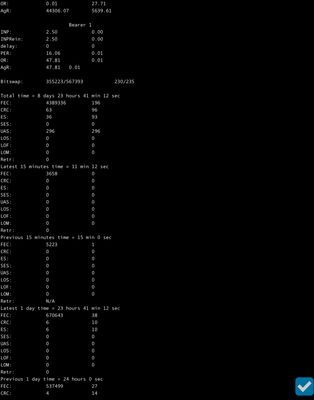

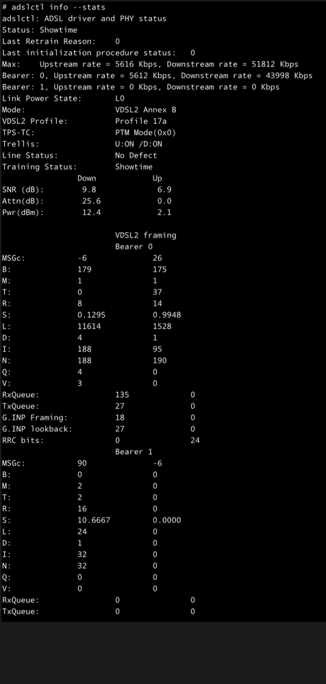

Don't worry too much about only eight days connection, we had a power cut last week. Picture 1 shows syncing at 43998 Kbps with a maximum fluctuating around 52,000 Kbps. This is with download snr of between 9 and 10 dB.

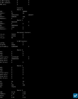

Without the banding at 44 Mbps, with G.inp and vectoring working properly, the line is stable at 60 Mbps with a snr of 3 dB. The high UAS figure on Picture 3 is only due to training the vectoring on connection, as can be seen on picture 4 with the difference between link time and system time being 5 minutes.
As with @JohnnyFP 's post, I have two university students trying to work from home, one of them in the third year of a computer science course who uses a lot of bandwidth on a VR project, so any improvement would help all of us.
Banding has been in place since last year following a problem at the local cabinet when the mains power feeding it shorted out. It took so long to be fixed that the batteries failed leaving power to go on and off multiple times as UKPN repaired their connection.

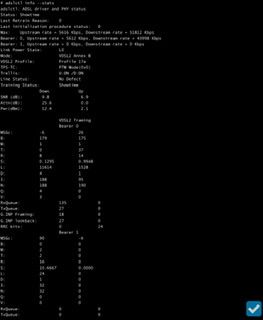

Don't know if just me but only page I can't read is page 1 as just blurs when I try to enlarge
5,920 Views
Message 3 of 11
Re: Profile Reset Request
Yep, just trying to sort it out thx.

@imjolly  It's not just you.
5,896 Views
Message 5 of 11
@imjolly  @pippincp Try this.

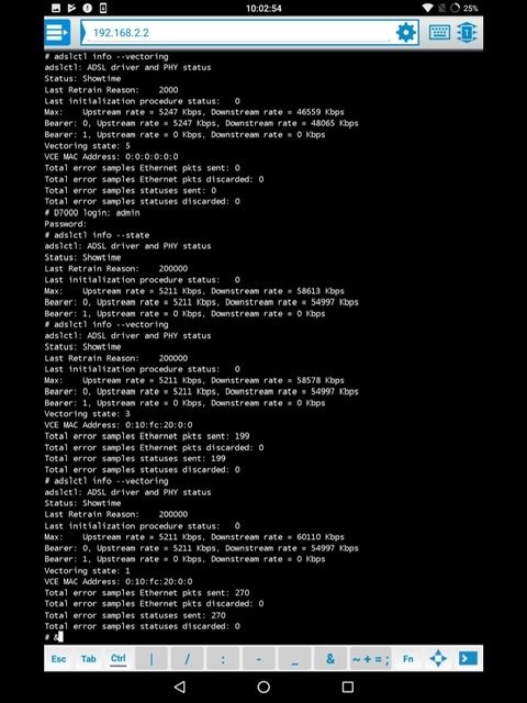

This is just to show progression of stats in one morning as vectoring and G.inp kick in moving maximum rate up from 46Mbps to over 60Mbps.

@NoSirItWasntMe
that's better and can read that now
can't see anything in stats that shows internet connection time just system uptime which is something different.  Is there anymore stats that show internet time?

@imjolly
Picture 3 shows total up time 8 days 23 hrs 41 minute 12 seconds.
Picture 4 shows link time 8 days 23 hrs 36 mins 15 seconds.
As I said above the UAS number of 296 seconds is due to extended handshake configuring vectoring.
