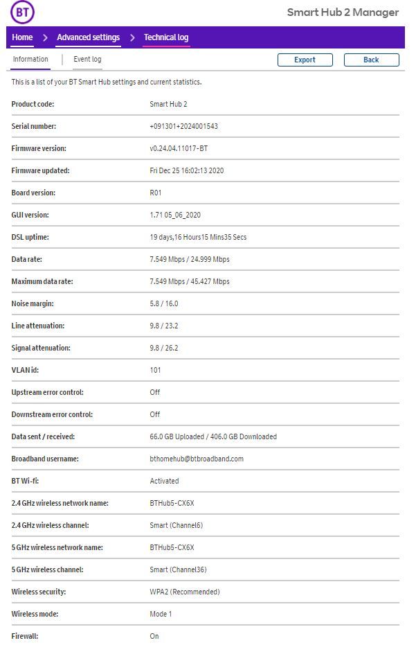

Hi @Willscott64 welcome to the community and thanks for posting, I'm sorry to see you're having problems with your broadband speed.
Can you post stats from your hub and we'll take a look? If you have a Home Hub 5 go to http://192.168.1.254 then go to troubleshooting, helpdesk. If you have a Smart Hub its advanced settings then technical log information enter your phone number and post results.

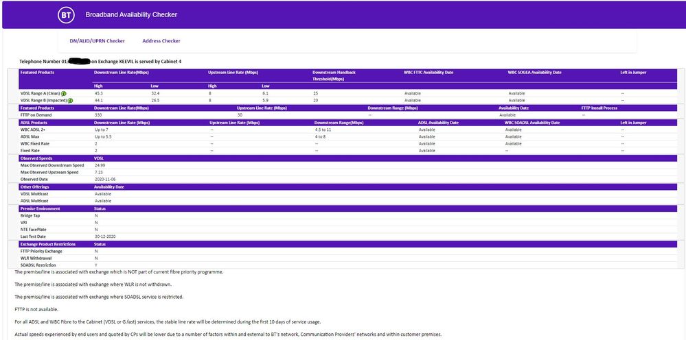

Have you had problems with your router dropping connection maybe oct/Nov and subsequently have had it fixed as line looks stable now
you are in a banded profile which is normally caused by unstable connection

Your speed was at the same 24.99mb on 6 November so nothing to do with your contract renewal. This reduced speed is from an unstable connection dating back to at least November and probably earlier hence the banded profile
your estimated speed range is 45/32mb according to dslchecker

They have done nothing. As @imjolly  has stated it looks like the line has been unstable recently and DLM has taken action to stabalise the line.
