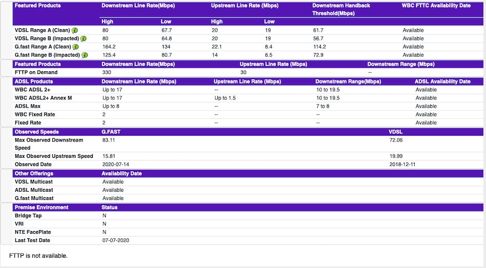

I'm attaching below a screenshot of the BT Wholesale broadband speed checker site for my exchange - Newtown Llantwit - box 28. Does this help with an evaluation of my problem? Many thanks.
