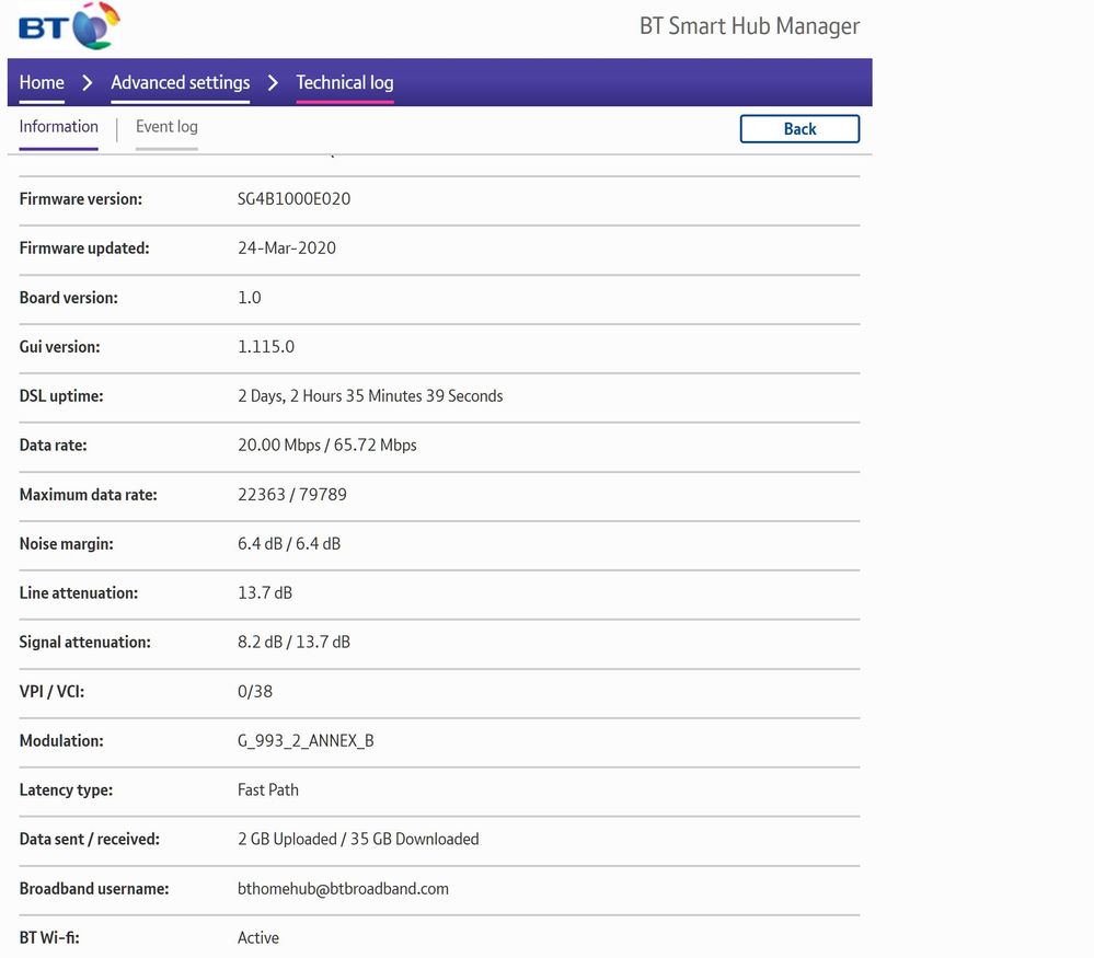

The download speed isn't ok if my amazon/Netflix viewing as it is constantly buffering at peak times. I pay for a service that was originally fine, but now even during the day has its up and down times. with no one at home apart from me who is on quarantine

connection time is only 2 days is that due to hub dropping connection or manual reset?
with a 65mb connection you should not have problems with downloading   are you using ethernet or wifi?  if wifi then try ethernet

I have not touched or reset the router in months (probably last time was when I got the new hub)
I use a wired connection straight into the back of the router

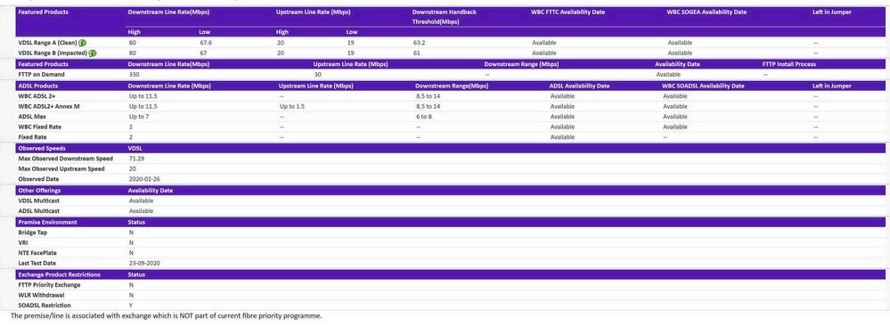

Have you done the quiet line test?  If so was there any line noise?
can you post results from the dslchecker by entering your phone number
