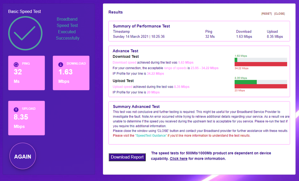

For the last week, like clockwork my download has been dropping something serious as soon as we reach peak times PM (5pm onwards). However, my upload remains perfectly fine which I see as very odd.
Normally, I get around 35 down, 8-10 up. But when *something* happens my download will drop as low as into the Kbps range while my upload is completely fine.

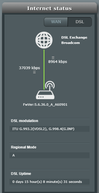

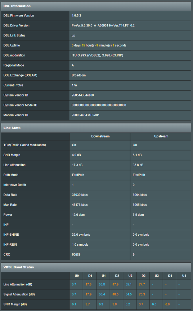

Swapped the Huawei Openreach modem for a known good DSL Modem but the same thing happens making me think this issue is outside of my domain. Network usage at this time is also very low - no streaming, no games etc as everyone has to flip over to 4G on their phones/tablets to at least get some connection.
Similar searches on here seem to suggest either oversubscription at the cab/exchange or a SVLAN issue.
Also did a silent line test - that was fine and my modem is reporting a good connection to the DSLAM with the expected line speeds.
Can anyone shed some light on this one? Don't really want to call BT support.
