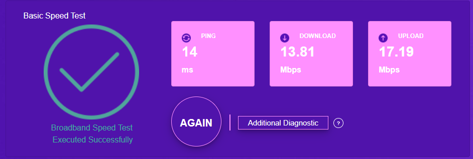

This was my https://speedtest.btwholesale.com/details test.

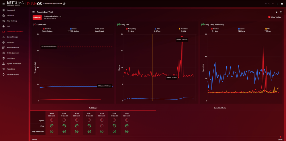

This is the NetDumaos/ test. Its in the most detail. You can see my first test since I rebooted my router at 12:50 am to about 12 hours later. Under 'speed test' the dashed line is where I normally get and the solid line is what I'm getting currently. The middle section saying ping test has normal results however I lost 1% packet which is also worrying.

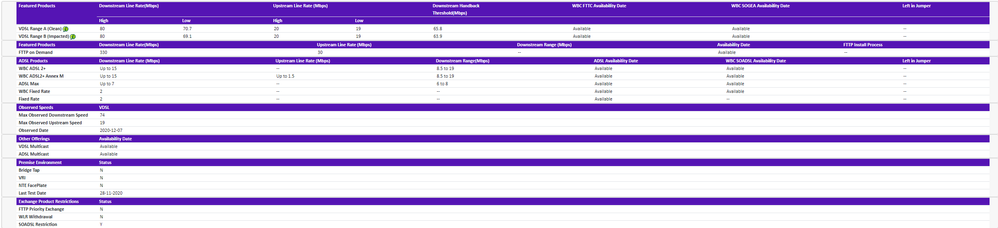

Also here is my https://www.broadbandchecker.btwholesale.com/#/ADSL/telephoneHome page.
My Cabinet is CIRENCESTER is served by Cabinet 20
