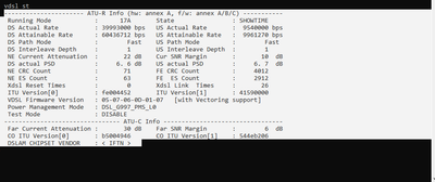

I use the Draytek Vigor 130 modem and ASUS RT-AX88u router, which are flawless.  My connection never drops and has very few errors according to the modem stats.
Does anyone know if BT/Openreach will do a line reset to try and get our speeds back up to around 45-50 prior to installing a second line? I think we would be ok if we had our original speeds back, but it seems DLM will not increase our speed despite it being solid for months now.  Last year I had lots of disconnects using a TP-Link modem/router, so hence why I think my line was locked at 39. I would prefer just having one line rather than paying for 2, but I have to do something.
Modem stats below.

I think from your stats you are stuck in a banded profile hence the 40mb connection regardless of anything you try.  I have asked mods to see if they can help you and they will post here
from your stats your up speed looks ok and virtually at max attainable

Thank you for posting. I would agree with @imjolly, it does look like your connection has been banded. If you send me your details, I'll be able to take a look at your connection and run a few test on your line.

Thanks @imjolly, @PaddyB and @DavidM for all the help. OpenReach engineer confirmed line was banded and profile set to 40/10, despite the line being capable of more.  After much back and forth with BT my speeds are back to what I had years ago (53/10) so am very happy.
