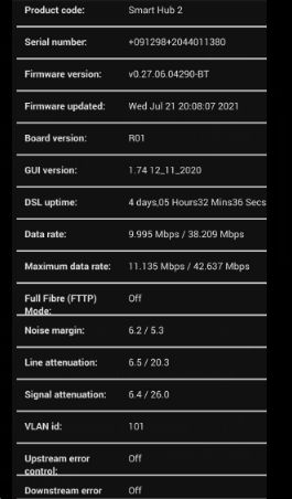

Hi sorry your right iam on Fibre 2 not 1 . This connection same DP and only difference its a new line install. connection is direct from Master no extensions.  I have had BT engineers out previously and have a new Master and put on best connection they say in the under ground pit near the pole on my BT connection

from your stats the max attainable is only 42mb so cannot see you getting much faster than your 38mb.  have you tried using the test socket with a filter to see if that helps?  is there any line noise when doing quiet line test.
no 2 lines as the same even though from same DP
