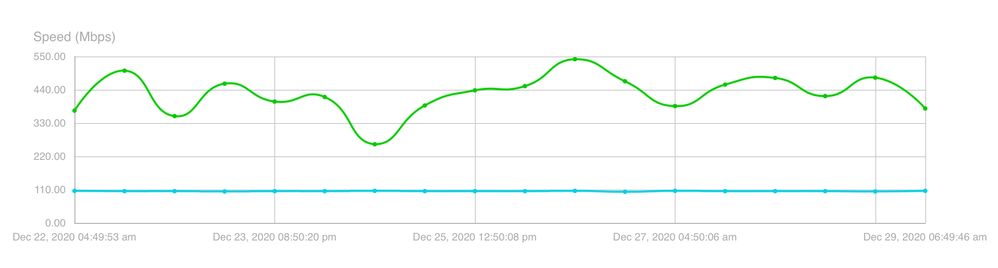

Here’s the latest speedtests from my latest router TL-R605, connected into the Omada SDN Cloud. It’s a legitimate router and as far as i know setup correctly but the speed tests it show similar to the last two routers i tested which are below the contractual limits even. I dont really know much about how it’s running the speed test so appreciate this is far from conclusive, but should at least be enough to want to investigate a little more.
