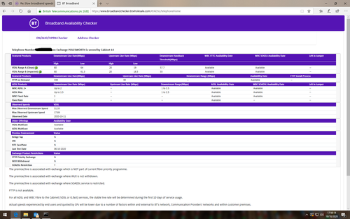

The quiet line tested OK the main router log is some 418 pages long saved as a .PDF file but I do not know how to upload it..
here are the results of https://www.broadbandchecker.btwholesale.com/#/ADSL

You obviously are not on fibre 1 as your up speed is 17mb and would be restricted to 10mb on fibre 1
your actual connection speed is virtually same as attainable and noise margin is down at 3.1 suggesting line good and G.INP active
have you tried using the test socket with a filter to see if that improves your connection?
