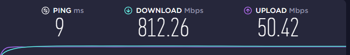

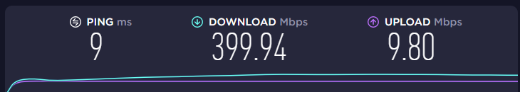

I am on BTs 900/110 plan and am having issues with the Smart Hub 2's ethernet.
It's strange, when I reboot the router or unplug and re-plugin the ethernet cable I get nice fast speeds but then within 5 mins my speeds drop to under 400mb down and 10mb up.
Ignore the 50mb upload speed, that's another issue posted in the thread about that, but as you can see:
Before reboot:
After reboot:
If I quickly unplug the cable and plug it back in the speeds go back to the 'after reboot' speeds (often the DL is higher, around 890mb-912mb), but this only lasts 5 minutes max, then the speeds drop back down again. This is also not just happening on speed testing sites, I have tried downloading/uploading to a webserver and the same thing happens. The BT checker always says 912mb/110mb, that maybe what the line is getting, but from the Home hub to my PC that isn't what is happening.

One of the well known problems on the SH2 is the Smart Setup utility, the intention may be good but it's anything but smart, disable it as shown here
What is Smart Setup on the BT Hub? How can I turn it on and off? | BT Help

Cheers both, turning off smart setup fixed it.
Just the 50mb upload issue to sort now in the other thread (it had gone but came back when I did a factory reset trying to fix this issue) 🙂

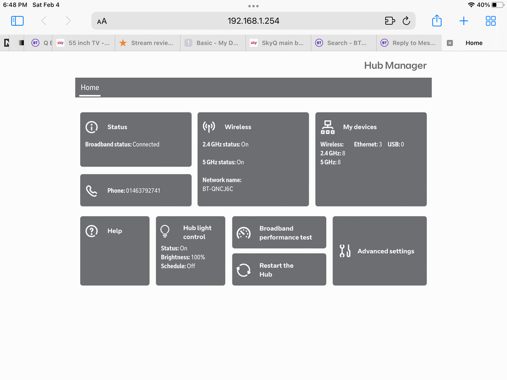

I have a different menu from the one shown on the link I can’t see an option to switch off smart ?78C0E88D-FA6C-4CD0-834B-42D48AF7006B.png
11,416 Views
Message 7 of 7
Re: Slow connection on Smart Hub 2
Go to solution
That's because Smart Setup no longer exists. This thread is 2 years old
