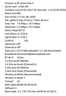

Can you post your Home Hub router stats and we'll take a look?
You'll get them by entering 192.168.1.254 in your browser, go to advanced settings then technical log information.

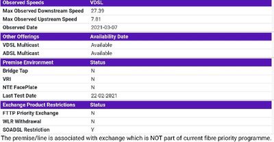

can you enter your phone number and post results  remember delete number before posting
the resets are not your hub updating but probably a noise problem causing hub to drop conenction
have you tried using the test socket with a filter to see if that helps by eliminating your master faceplate and any internal wiring
