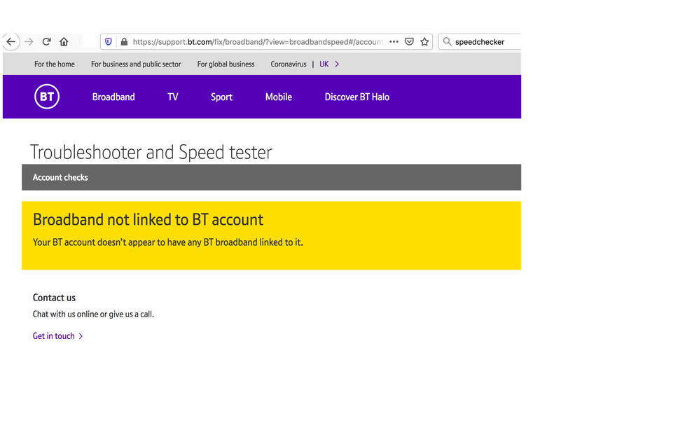

Re: Speed test detect my old provider

Thank you.
I have checked the speed on the BT official site and found out my account hasn't been linked to BT.
I am still confused.

You still haven't answered my original reply, in your emails, you will have a confirmation of the order, what date does that say you will join BT ?
Also, linking your account, have you created the BT ID ? you would of been sent an email with instructions on how to do it, if you were previously with BT before and have used the same email, this can cause multiple ID's, shouldn't be an issue if you use a different password though.
Go through your inbox, read the emails sent from BT, it has all you need to get started.

If you use the phone line the broadband is delivered over and call ( as already suggested ) 150, if BT customer service answer ( or you get a BT announcement) then your line has been switched , if you don’t, then it hasn’t....and as already stated, it’s not the date the equipment arrives that is the migration date, but whatever date you were told in the acknowledgement of your order.
It seems strange that your Bat router would sync to a TT service, but if a speed test is reporting the ISP as TT, something is odd, are you connecting to the BT Hub ( in other words you have searched for its SSID and set that as he default ‘WiFi’ for whatever device you are using ?

@iniltousNot strange at all. The broadband username and password aren't needed for authentication on the TalkTalk network when using a fibre connection. The authentication is provided by a tag inserted by the DSLAM equipment in the street cabinet. Just use any username and password, so the BT hub will connect.
There are 2 possibilities. Either the line transfer has not been actioned yet or the Talk Talk Tag has been left in.
