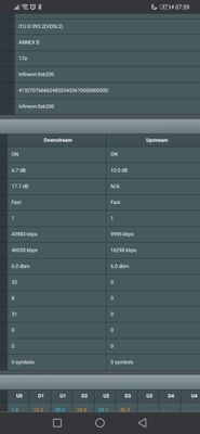

Please find the screenshot of stats here
Wester hailes, cabinet 2
https://ibb.co/xHzg4Rk

did you actually connect to test socket or just the master socket - test socket requires the removal of the master faceplate and use of a filter
your move back to 'slave' socket has dropped your up speed from yesterday at 16mb down to 10mb
there is nothing in stats which shows dsl connection time
can you when posting information post here instead of links elsewhere as make much easier to follow - use camera icon

I indeed removed faceplate, connected filter and run the router from test socket for 12  hours.
This morning i connected the router back to my slave socket as there was no change in stats.
It appears upload is at max but download underperforms.
Im on 50/10 connection I think its calld fibre 1.
Sorry for some reason i couldnt attach, i was getting an error that attachments exceed 333kb hence i used hosting service

Your connection speed is still the same as it was in your initial post 43983kbps
