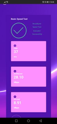

 Looks like my speed is going down the drain too
3,802 Views
Message 16 of 32
Re: Sync speed going down
That looks like a wireless speed too.
