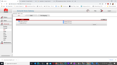

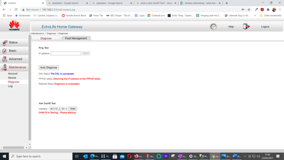

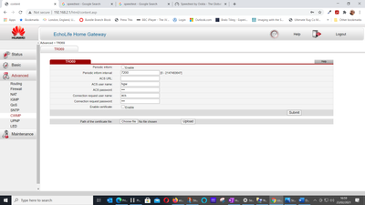

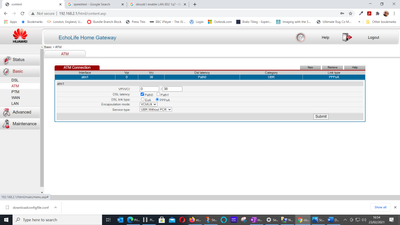

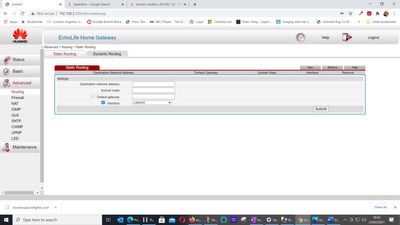

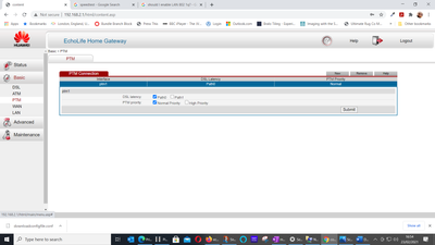

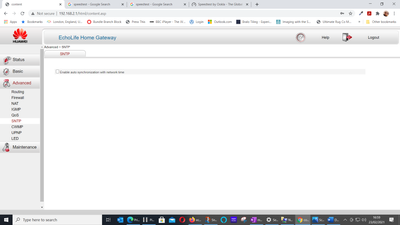

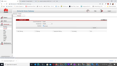

I have unlocked the EchoLife, changed LAN IP so I can access both, the modem and the router. Not sure if changing any other settings would make the speed better.

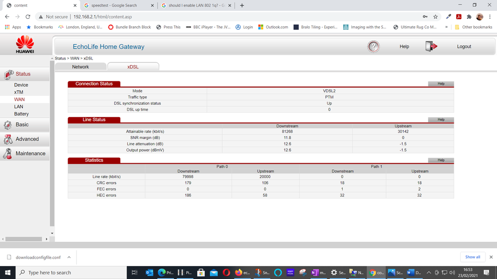

Can you post a screenshot of Status > WAN > xDSL please?

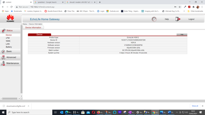

@massimog
What version of firmware did you use to unlock the HG612? The SP08 is the one to use as I recall as the SP10 doesn't support G.INP which could explain the speed difference.
5,305 Views
Message 6 of 10
Re: Third-Party Router

From the modem stats you have an 80/20mb connection
5,286 Views
Message 9 of 10
Yep, you are getting the maximum speed possible for FTTC
