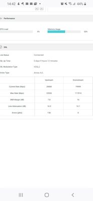

Updated router to latest firmware the beta one this morning.
Solid all day kids have not had problems using there home schooling apps.
But I've started having bad pkts

I would not worry about a few packet errors on the upstream path, as that part is mostly located at the highest part of the frequency spectrum, so I would not be surprised to see some errors.

Packet losses (CRC errors) are caused by uncorrected line errors, and nothing to do with MTU.
DLM (Dynamic Line Management) will try to reduce these by interleaving and Forward Error Correction, but this happens over a long period of time, so its important that you leave things connected up. As it takes many weeks for the line to stabilise,

all seems well its alot more solid than the bt smart hub.     Albeit i still can't do a speed test on any device without it causing issues on all other devices.
But im getting alot better upload speed and download Speed is consistently 70mb
