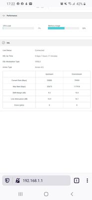

Hello bought this as it says its fully comparable with bt infinity
All set up okay disabled ipv6 as was told it doesnt work with bt
All okay speeds sync at 80mb and 20mb
But not getting no were near them wired or wifi
Also if I do a speed test it knocks all my devices off ?.
When speed test finishes the devices all come back on?
Over tried qos and nothing also tried ipv6 on and nothing makes it better?
Is this a router issue or bt?

I have the same, and although I am starting from a much slower speed, I don’t see the issues you have.
Would be worth running a quiet line test and see if you get any noise, and update the firmware to the latest version.

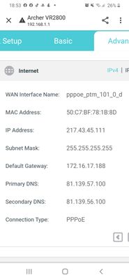

I wondered also is there a different login details for vdsl infinity?
5,398 Views

Just the usual user name and and password

Speeds are up.   But still if i do a speed test on my phone or any other device it knocks all other devices off line until the upload part of the test is done?
