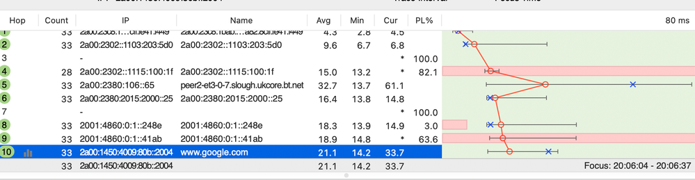

Screenshot 2021-03-13 at 20.11.20.pngPing plotter results to google. Hope this helps... have no idea

There is no packet loss in that trace.
Understanding traces is the key. If the destination reports packet loss then you look backwards to try to find out where it occurs. Your destiation shows 0 packet loss. How could the packets get there if they were lost on the way?
What your trace does show is that 2 routers are configured to refuse ICMP requests (100%) and the others are quite rightly are treating them as low priority and concentrating on what they are supposed to do, forward the traffic.
