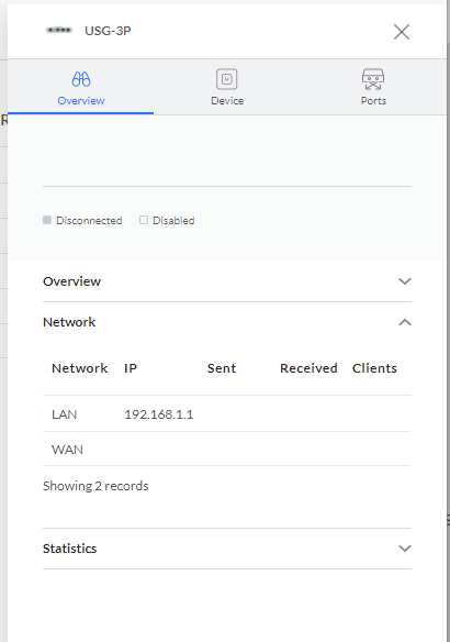

I've adopted the USG into the Ubiquiti Controller and both the Wan and Lan ports on the USG are green. However, there's no internet.

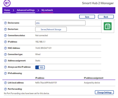

I change the IP on the USG and that instantly reflects in the Unifi Controller, then a browser refresh later its back to 192.168.1.1. I noticed in the SuperHub setting its set to a static IP on 192.168.1.1 but there's no means to change it. What looks like a button 'Always Use this IP' is locked and also link local address states 'Assigned by Device'. I'm four hours in, on this and it's driving me nuts, the Unifi config is so awkward and counter intuitive.

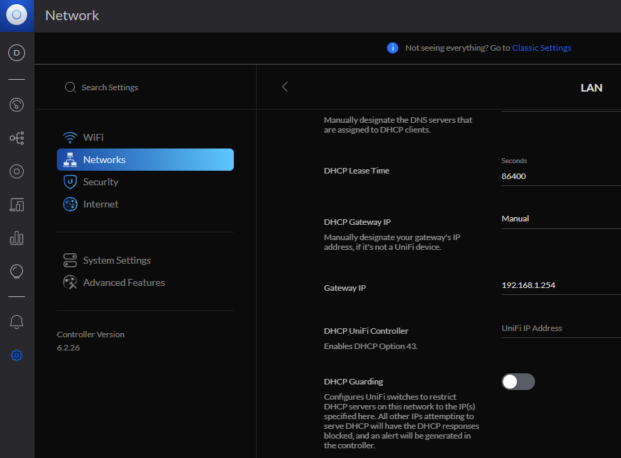

192.168.1.1 will be ok. Is the gateway set to 192.168.1.254, that's the important bit.

Yes the Gateway settings were pretty straight forward

I have noticed that the WAN port never gets an IP address from the Smart Hub. I would have thought that it should have one?

Okay so the USG LAN by default gets allocated 192.168.1.1 and I should manually set the USG WAN to 192.168.1.10. I would have thought the SuperHub would have automatically given the WAN port an IP, it only seems to have the LAN port registered
