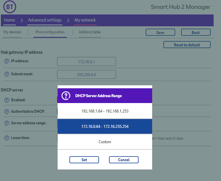

@licquorice Thank you so much for you help today. 8 hours later and I've just fixed it.
It was a simple setting in the Smart Hub2. Basically both the WAN and the LAN were on the same sub net. All I had to do on the Super Hub2 was change the Server Address Range in Advanced setting > My network to 172 range and that stopped the WAN clashing with the default Ubiquiti USD range of 192. After than I had to reboot everything (including the Super Hub) as well as any machines connected via wired connection to the switch. For anyone, who gets the same problem, here are my settings. ..

It would have been much simpler to have used a different subnet for the USG I would have thought, but hey ho, glad you got it working.

I then connected to the BT WiFi, logged into the admin interface and went to Advanced Settings -> IPv4 configuration and in there selected Server Address Range and changed this to the 172 range (172.16.0.2 - 172.16.255.254).
I found that I had to leave DHCP enabled otherwise the USG/UDM wouldn't show up when connected, and this is needed later.
Once the Smart Hub reboots, you can then access it via 172.16.0.1 to carry out any further admin.

In my efforts to troubleshoot the DHCP clash I changed the IP range on the Smart Hub DHCP to the 172 range. The default 192.168.1.X range was visually too close to 192.168.0.X and was making it hard to be confident in what I was seeing at a glance (I don't fully understand how subnet masks work in this context and wasn't in the mood for learning), whereas it'd be super obvious if any device thought it was on 172... that was my thinking anyway.
I don't know now whether it really made a difference, or if it even can work that way.
