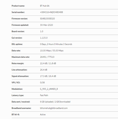

Anyway, here are my hub stats:
Grateful for any advice. I'm still within my 14 day cooling off period so I'll cancel if this is as good as it gets.

Why are you only showing a 2 hour connection time, as you must leave things alone, otherwise the connection speed is unlikely to improve, as restarts or disconnections during the initial 10 days, will be seen as a fault and your connection speed will be restricted?

You would appear to be still on the Fibre 1 profile as can be seen by your Data rate being a nice 10/55Mbps when it should be above that going by your Max Data Rate.
You need to contact BT and ask them to confirm that your broadband package has been updated.

Hi
That was when the home tech expert was here. I think he rebooted it.
Cheers

Your line is obviously on Fibre 1. The 10/55Mbps is the Fibre 1 profile. If you were on Fibre 2 both these numbers would be higher and nearer your max data rate which is what your line can support.

Thank you very much. I was hoping someone would say something like that.
I'm going to try and push this now I have some evidence.

Update is that I am being sent a replacement hub. This is after I reported that it can't be factory reset. Should be with me on Tuesday. The case has also been elevated to OpenReach.
Very pleasant support agent was again of the view that the speed was good considering distance from the exchange. I don't disagree that it's good for Fibre1. It's just not that good for Fibre2, as I keep trying to explain!
